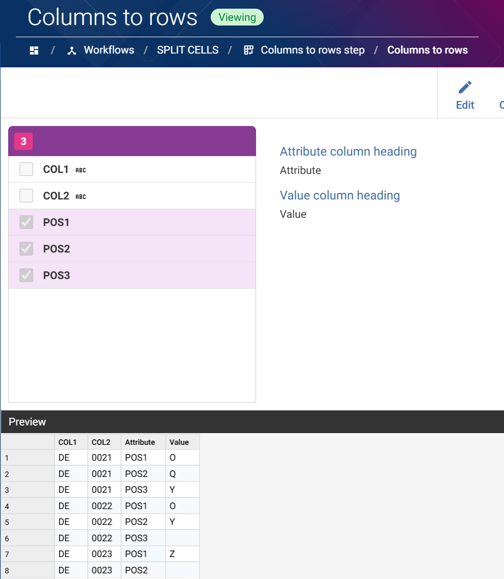

I did this by splitting the 3rd column (OQY etc) into separate columns. Then I used the columns to rows function.

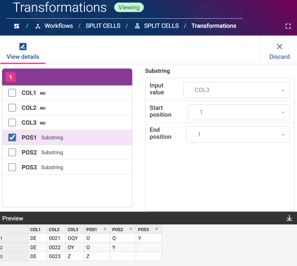

Do you know the maximum number of characters that could be in the third column?
If the answer is 3 then copy the column twice using a transform step and use the Substring Function to extract the 1st, 2nd or 3rd character depending on the column (will be null if there is no character)
Then use columns to rows workflow step and James suggests
Thank you both. The highest one I found would be 6 characters. I assume I just replicate these steps but for a higher number of columns. Thank you again for the help :)
