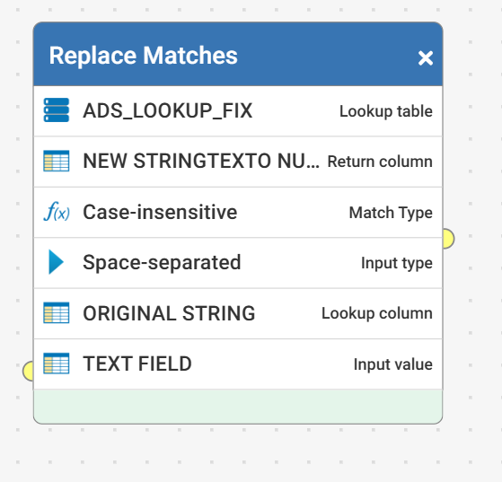

  • James T Sidebotham
    James T Sidebotham Contributor
    edited September 30
    Still use the lookup table, but use the function "Replace Matches"? I tried and seems to work within a comments field (space separated values before and after) with your original strings
    edited October 20
  • Alfredo Monasi
    Alfredo Monasi Experian Employee
    Thanks, it worked when is a whole word to replace with spaces. For other case inside a string I had to use a replace.
