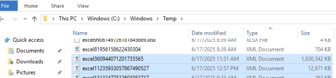

    5. Check for large "excel<number>.xml" files in C:\windows\temp. These may be created after data is downloaded from a "View" only as Excel file, and can be safely deleted. Note that from v3.1.8 this issue was resolved and the temp files are no longer retained. image.png

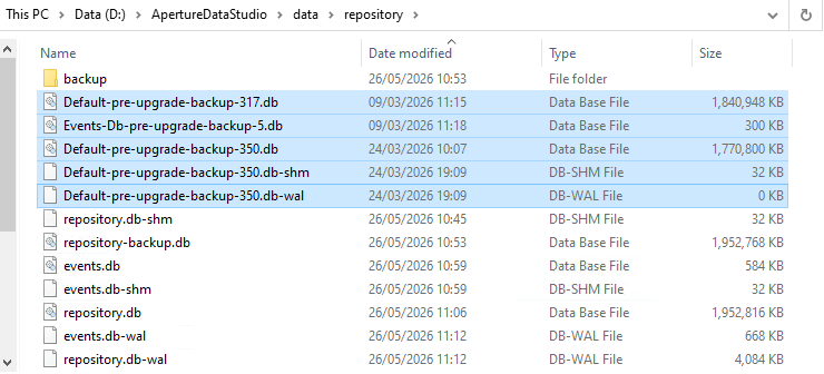

    6. Review repository backups and backup settings. You may have old backups from previous upgrades that can be purged. Be careful not to remove recent backups or your current repository. If in doubt, ask!
      1. In addition to the default cycle of repo backups, Aperture creates a separate backup for each upgrade. There are named "*pre-upgrade-backup*" and are not automatically deleted. Older backups can likely be removed if the upgrade was successful: image.png
