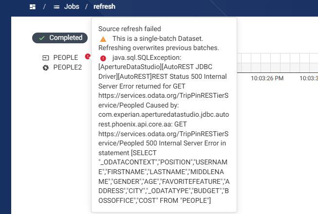

    It looks like such transaction cancellations can return with a 200 (OK) response, meaning the AutoREST JDBC driver won't know that there's been a problem retrieving the full dataset.
    If a error code such as 500 (internal server error) is returned by an API during a request, the AutoREST driver will pass this back to Data Studio and report and error, which can be handled in several ways:
