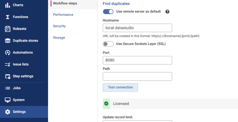

    You can also check Settings > Workflow Steps > Find Duplicates, and see what settings you have there are working…

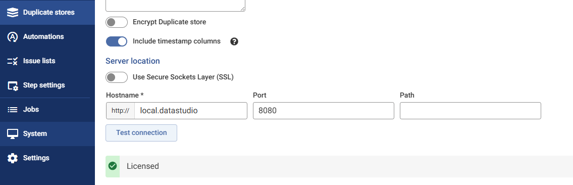

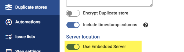

    These setting should typically match these settings when creating a duplicate store. For embedded, the store server will default to Use Embedded Location
    For a remote location, you will usually just need to leave the "path" part blank:

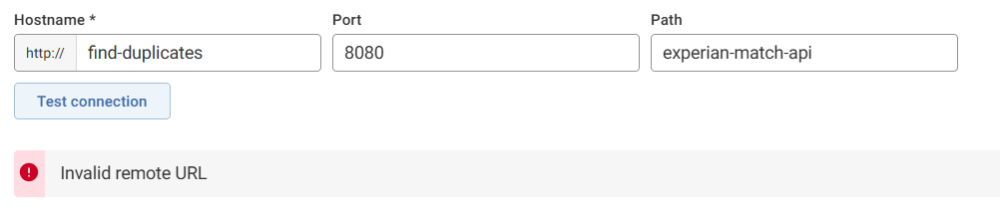

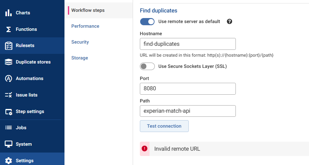

    Thanks a lot for your help. This is how I see the license information.
  • Henry Simms
    In your case the connection isn't being successfully established between Data Studio and the separate find duplicates service. This could be for a few reasons, most commonly:
    • Find Dupes service not accessible (hostname or port is not correct, network firewall blocking connection etc).
    • Find Dupes services not started
    • SSL certificate issues: Data Studio does not trust Find Duplicates.
    The datastudio.log should give some information about the reason for the failed connection, so I would suggest checking there first. You many want to contact our support team for troubleshooting
