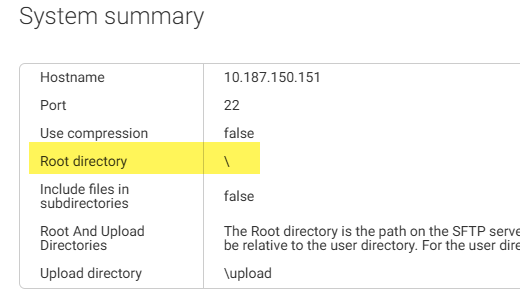

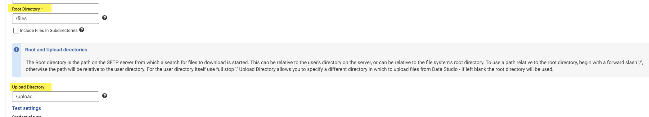

    One thing to note is that the Dropzone will be monitoring for files in a location based on your External System's Root Directory while files exported to the External System from Data Studio may be using a different Upload Directory if one has been specified. I have a test setup like this:
    When I remove the "files" folder from my SFTP server itself, my Data Studio exports still work but my file watchers error with something different to yours:
    INFO c.e.d.d.ExternalDirectoryWatcher [ExternalDirectoryWatcher-fe68fb99-9772-472f-8903-52ab25738f1c 1794115766] Error fetching file for external system: rebex (SFTP) [Environment=Demo] [externalSystemUuid=fe68fb99-9772-472f-8903-52ab25738f1c] - File not found.
    I wasn't able to recreate the Specified file path is invalid error

    Root Directory just "\" (my SFTP is on Windows)
    Folder to use as dropzone is set to a path relative to root
    The dropzone in this setup is working as expected and files are loaded to the Dataset

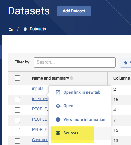

    I see above that you reported seeing "External system not found". Is that still the case? That suggests that the link between the Dataset and the External System it came from is lost. It would be worth looking at the Sources:
  • Thanks for checking. The system did seem to be 'not found', leading me to believe it was a network issue. However, I added the external system again and within each dataset I changed the source to use the new external system (and dropzone), and the files are coming in now.
