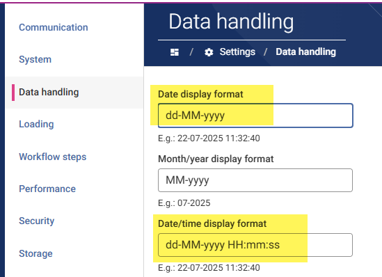

Once your data is in Data Studio, there's just one data type, DATE. Values in a lot of different formats can be parsed to DATE. The date and time display formats control how the values are shown in the UI, but the are stored in a consistent way.

The value that is displayed without a timestamp, 20-02-2025, still has a time component (it is actually 20-02-2025 00:00:00), but you're not seeing it because of the display format I mentioned above:
"Date" in this context is just a Data Studio DATE type with a time component of 00:00:00.000

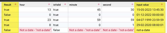

Result (including test values also created by the GenAI:
