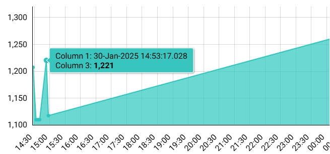

    I am not able to replicate what you are seeing. However I update the column values, the Chart is able to be plotted as expected:
    Suggest some trial and error using the Date functions until it works:
    or hopefully someone else has seen similar and can help

    @Josh Boxer this is also not working when I have timestamp. but working when I just have date

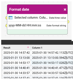

    is it so that I need to make it in this format?

    I loaded these rows as alphanumeric values, but was still unable to replicate what you are seeing with your charts. Column1:
    (i cannot see why it would change the behaviour, but place a Sample/limit the number of rows to 20 before the chart to see if that makes a difference).
    Yes you could try formatting the column values to see if that makes a difference to you
