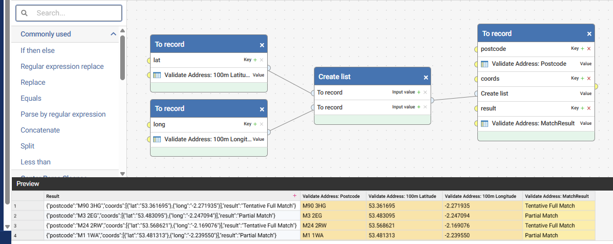

  • I was recently asked a question around creating JSON objects:
    From our data, we are trying to generate a json file like this one:
    {"key1": "value1", "key2": [{"key21": "value21"}, {"key22": "value22"}], "key3": "value3"}
    We are having an issue with the "key2", which it's value is a list of json, and it's being difficult that a workflow step handles this type appropriately.
    The approach for creating the "key2" (array containing two JSON objects) is to use the Create list function to create a list of the "key21" and "key22" records.
    In my example below, I have four columns:
    • Postcode
    • Lat
    • Long
    • Match Level
    And I want to create an equivalent JSON structure to the one in the question:
    {"postcode":"M90 3HG","coords":[{"lat":"53.361695"},{"long":"-2.271935"}],"result":"Tentative Full Match"}
    In my example "coords" is the "key2", and its value is an array of two JSON objects. This is created as follows:
    Note: In my example I've kept all data types as string for simplicity. In reality I'd likely want to use To number on the lat and long values before creating those records.
