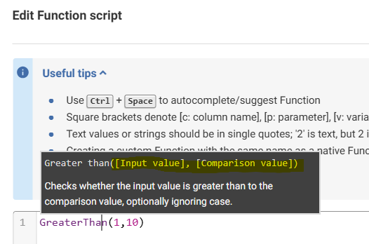

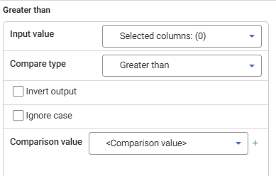

    Not sure I fully understand how you know how the variables map, but I assume in the MoreThan example: the Compare Type is not a "real" variable in this case, so ignoring that, it's purely the order they appear in the UI?
    edited October 2025 Answer ✓
    If you open the Function script editor you will find it easier to determine the variables and the order:
    Also the team provided a load more examples which will be useful:
