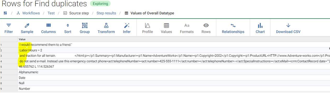

    • Currently, the rule you have set up says that as long as column name matches to certain extent, the rest of the attributes doesn’t matter. (because you used the OR condition for Column Name).
    Match.Close={ (Datatype.Close & MCF.Close & Tags.Close & ApertureTags.Close & LengthDeviation.Close & AverageLength.Close & FrequencyDeviation.Close & FormatFrequencyDeviation.Close & StandardDeviation.Close) | ColumnName.Close }
    For example, these rows for rowguid have quite different values for "most common format" but they will still be clustered together because the column name matches exactly. If this is not your desired outcome, then perhaps you should consider removing the ColumnName condition from the rules or refining the match conditions.

    • There is some "dirty" data in the Data Type and Most Common Format columns. Performing some data cleaning upfront would improve the matching results.
