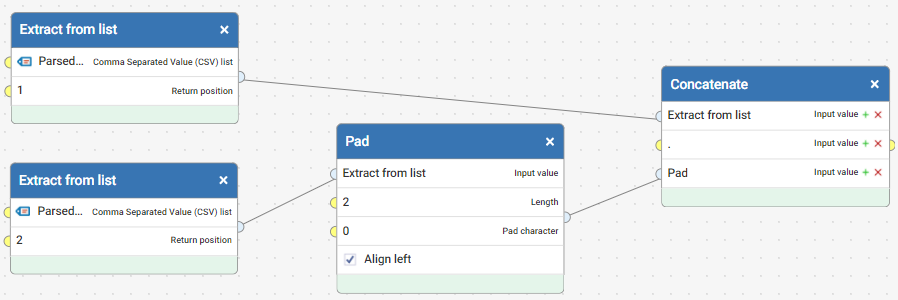

    I had another go at this using the Regex I mentioned to get a better solution without using an If then else.
    1. replace any characters in the string that are not a number or full stop
    2. round to 2 decimal places
    3. parse so that each number in the string is placed in a comma separated list:
    Now you have a list, you can Pad zeros to ensure there are always 2 characters after the decimal point:
    Concatenate the first number then a full stop then the padded second number
