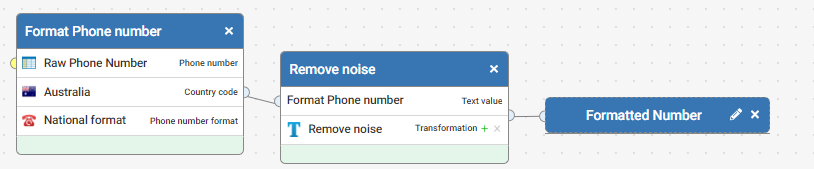

    Hi Everyone

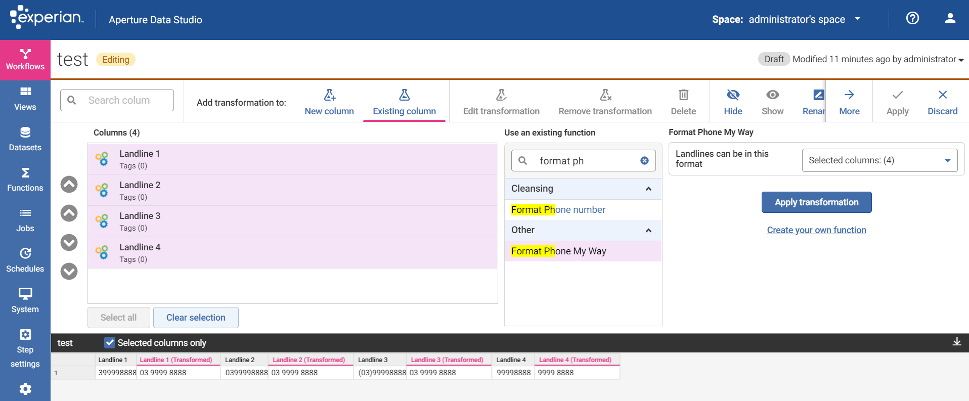

    Thank you for your quick replies. I looked at all your answers and it helped me come up with the fix. I did it differently but the above helped me resolve it. I did the following:
  • Clinton JonesClinton Jones Experian Elite
    @Carolyn cleverly done. Just out of interest. What application did you use to copy /cut the screenshot ?
