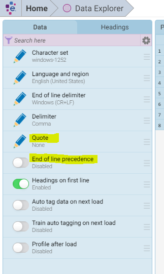

    Thinking more on this, it would probably be useful to call out that in the past we have seen issues with loading data from sources where there are orphaned quoted data, this has pretty much only been with loading files and not using JDBC connections. A number of improvements were effected in various releases to automatically resolve this including some major mods to the file parser.
    It is always useful to remember that these settings in the preview and configure can be helpful
    • forcing End of Line Precedence
    • Configuring the Quote
