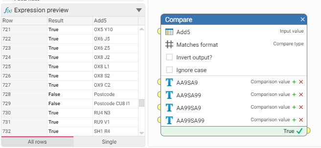

The easiest way to identify the offending rows is to either create a rule ahead of the export that filters out records that are too long, or to run a profile on the reworked data and look at the longest length. You can do this with a suitable validation rules.
Here's a simple one for length check
here's a different one for multiple format checks
These will also catch nulls and over length postcodes
You could also use a regular expression match or leverage a constant
